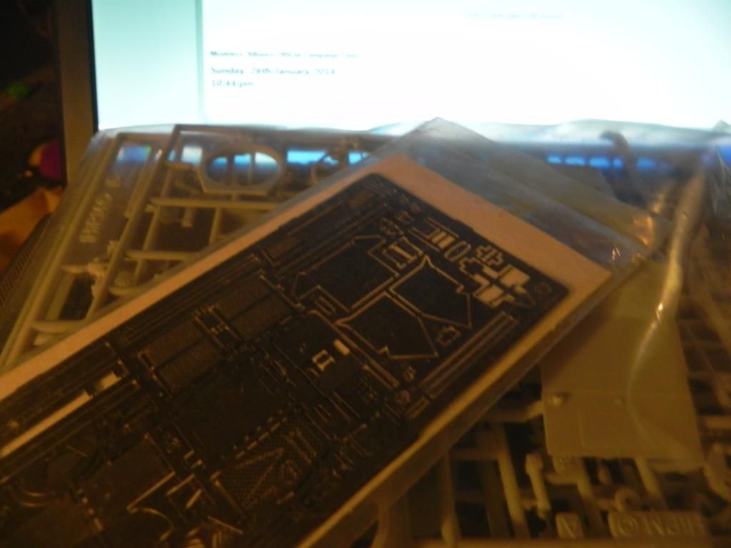

And the contents, still in the original bag, along with the equally old Eduard etch set. Sorry about the crappy photo, trying to get the time and kit together hasn't been working out too well for me :bang head
The worst of the worst part of this kit is the tracks, so I will push ahead with construction, and hopefully be able to get a set of aftermarket tracks (probably ModelKasten) before the deadline.

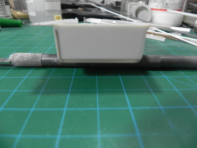

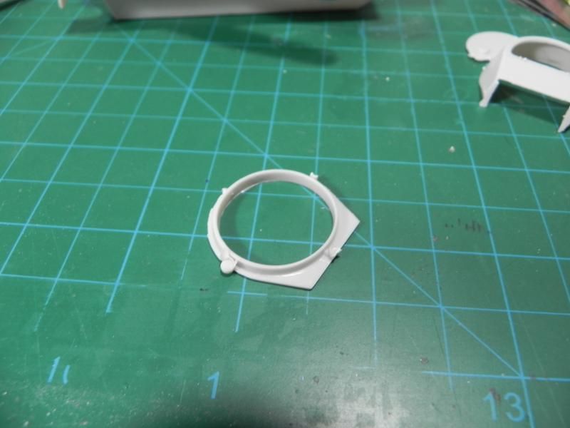

The sprue attachments are sometimes in really poor locations, such as the turret bottom. The large sprue gates are right on the bottom surface that sits on the hull :facepalm

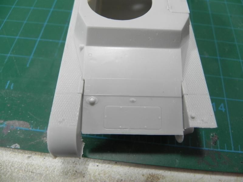

Test fitting the top of the hull reveals a decent gap on either side of the glacis plate where it should fit between the fenders. Some Evergreen shims will need to be added to fix this, but not much of a big deal.
The biggest problems with the kit concerns the lower hull and running gear. The fenders are very thick, so I thinned one as a test, using a Dremel tool and course sanding sticks, I figured if worked I could save on buying replacements. Plus, by thinning the fenders to as close to scale thickness as possible it would eliminate a potential large step between the fender and etch mud guards when they are attached, also if I choose to not add a mud flap the fender will be the correct thickness. While the picture is not great, the fender on the left has been thinned by about 2/3 its original thickness.

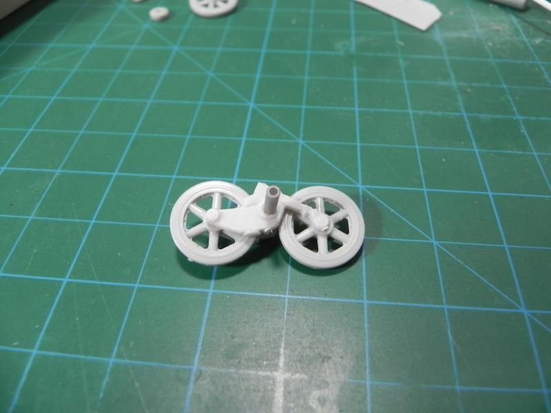

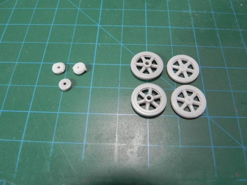

Did I mention the running gear is very poor??? The kit road wheels have a lot of flash and mold seams to clean up and the return rollers are more oval than round due to mold shift. Fortunately the parts boz coughed up a sprue of Italeri Pz.1 running gear, from which I am using the road wheels, return rollers, and possibly the drive sprocket. The hubs on the Italeri road wheels have a larger axel hole (well, the kit ones don't have a hole, you have to drill them out!), and the center hub is thicker by about .020. I think I have a solution, in that I made new axels from .030 Evergreen rod, sanded the center hub down to the same thickness as the kit hub, and made new mounting pins for the unit from Contrail tube. I will need to use the large rear idler wheel from the kit, as well as the swing arms, after a lot of clean up, but this might just work. The main concern is getting all the wheels to line up correctly so the track will run true. This photo shows the Italeri road wheels with the kit wheels to the right, and an Italeri return roller with the kit ones above.
And this is the mock up of the revised suspension unit using the kit swing arms and Italeri wheels with scratch built axels and mounting tube.
So far so good.
