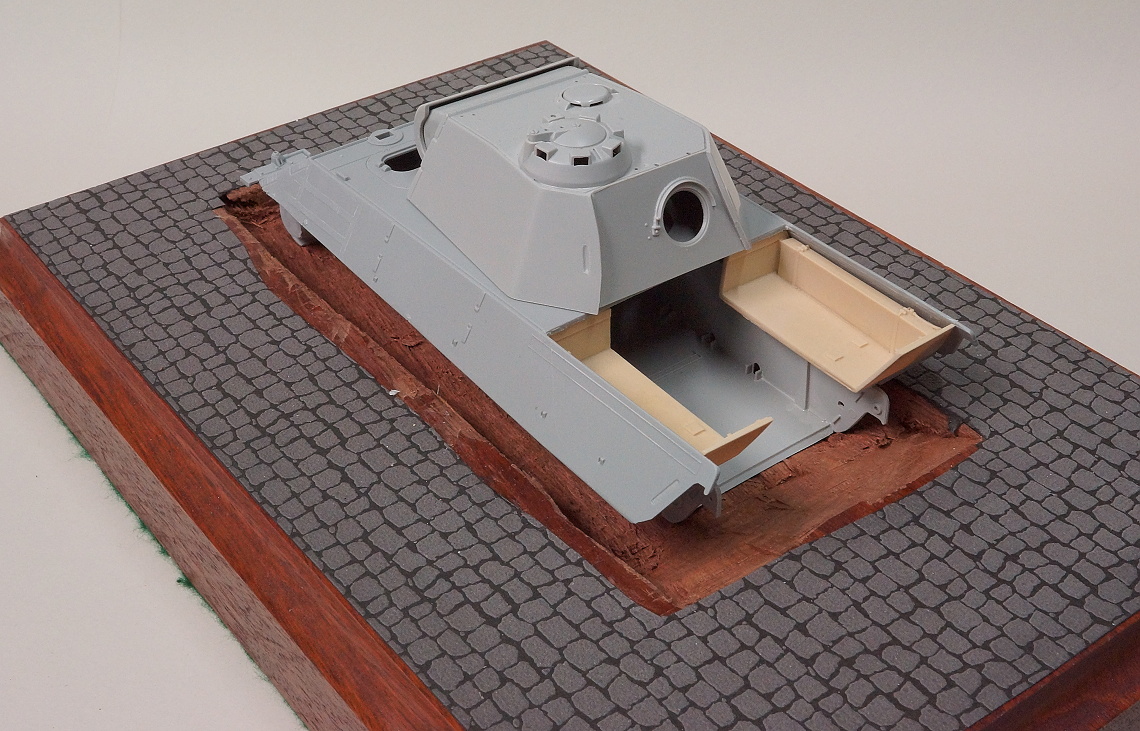

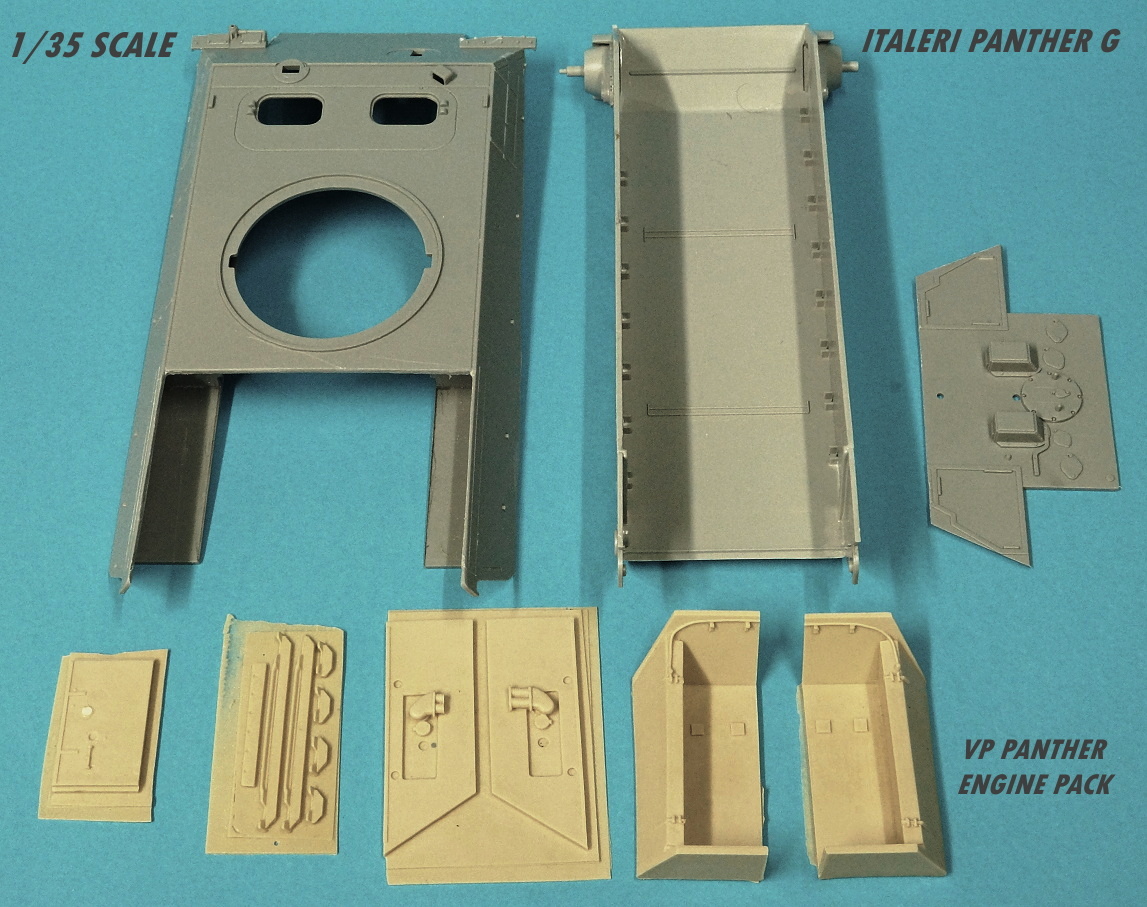

I am using the cheapest Panther kit possible as it will be basically a shell buried in the ground. The Italeri kit was the best candidate.

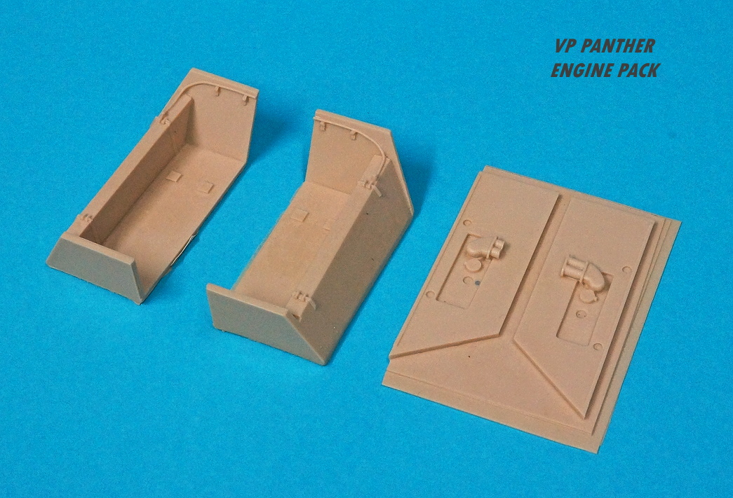

I also added the VP Panther Engine bay kit in resin for detailing the empty engine bay.

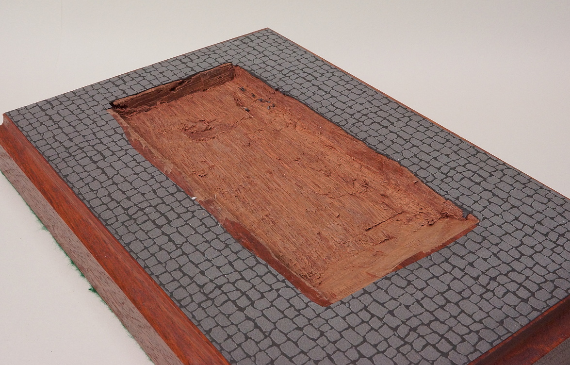

I have dug a hole in the base and added a cobblestone card surface as well as completing most of the tanks , cutting out what was neccessary.

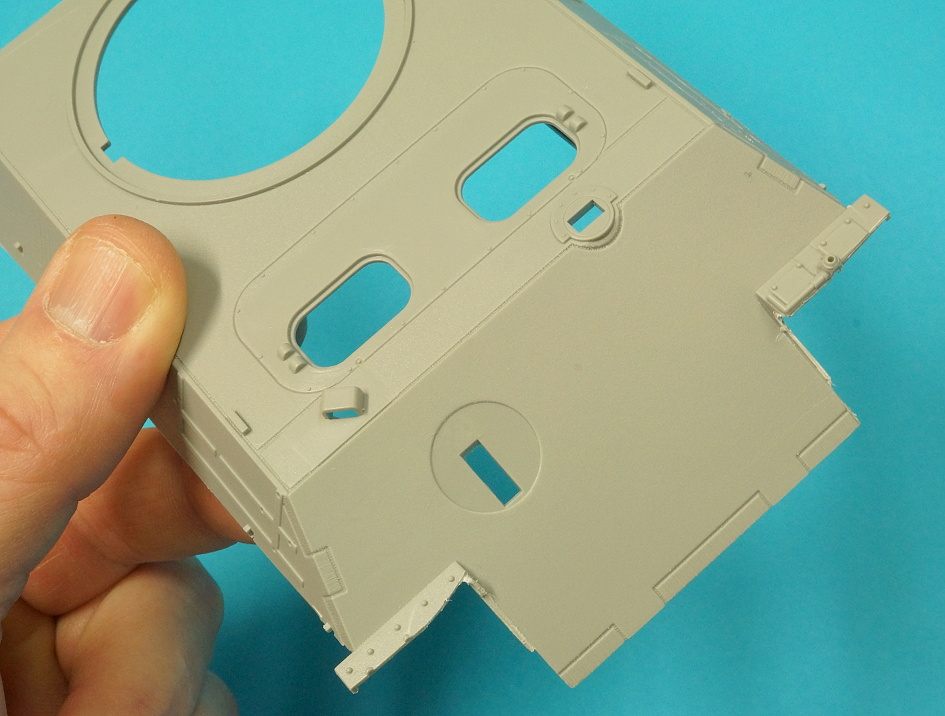

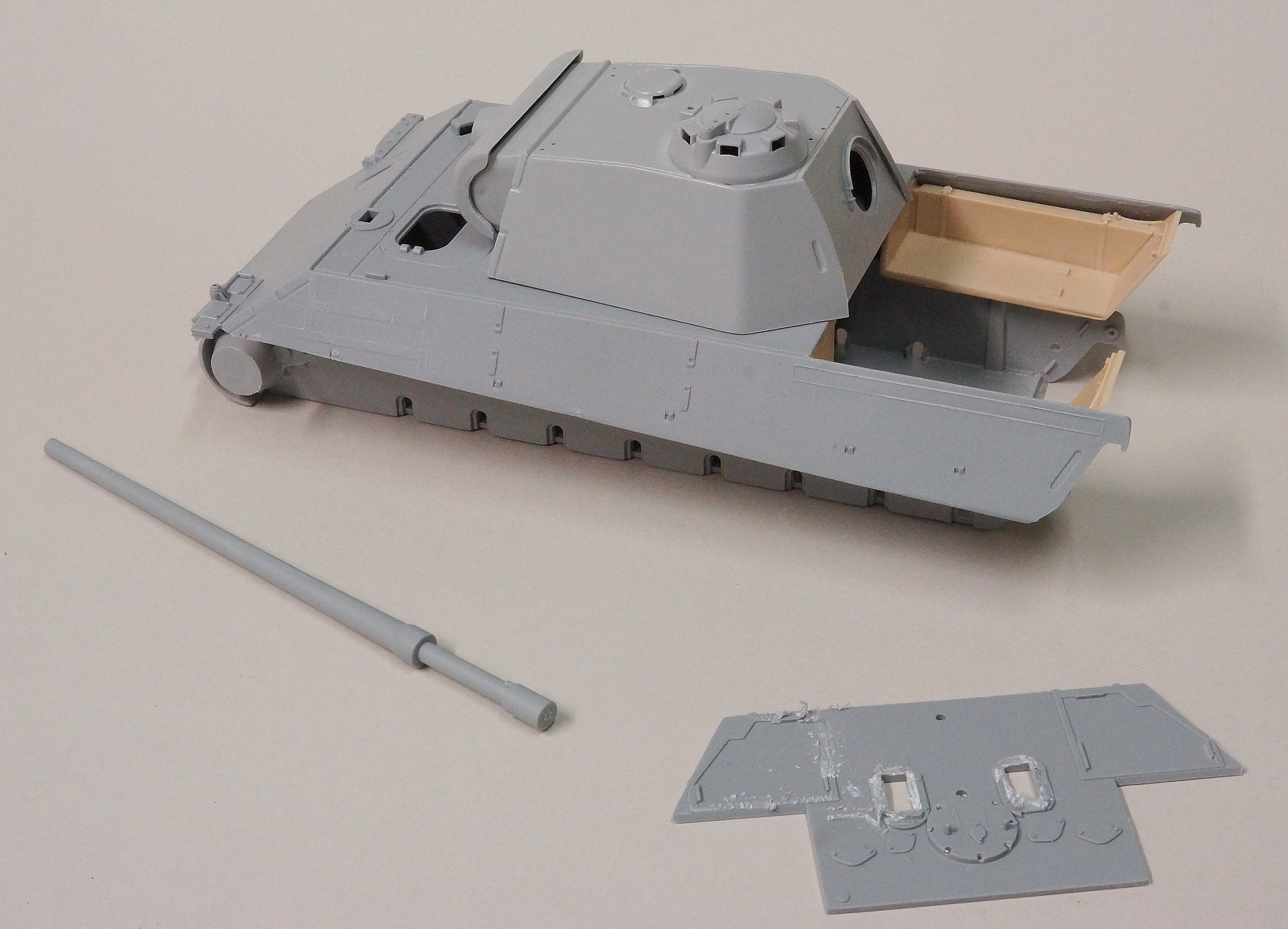

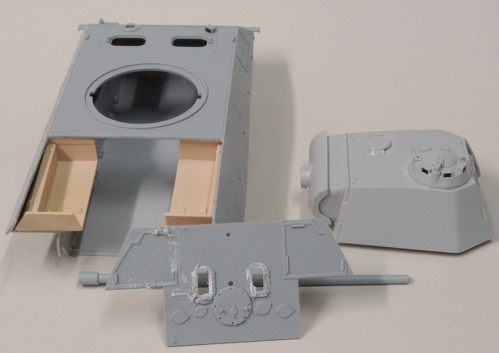

I am in the process of cutting-off uneccessary detail and adding/ modifying the engine bay resin to fit and look the part. Battle damage and zimmerit paste will also need to be added.

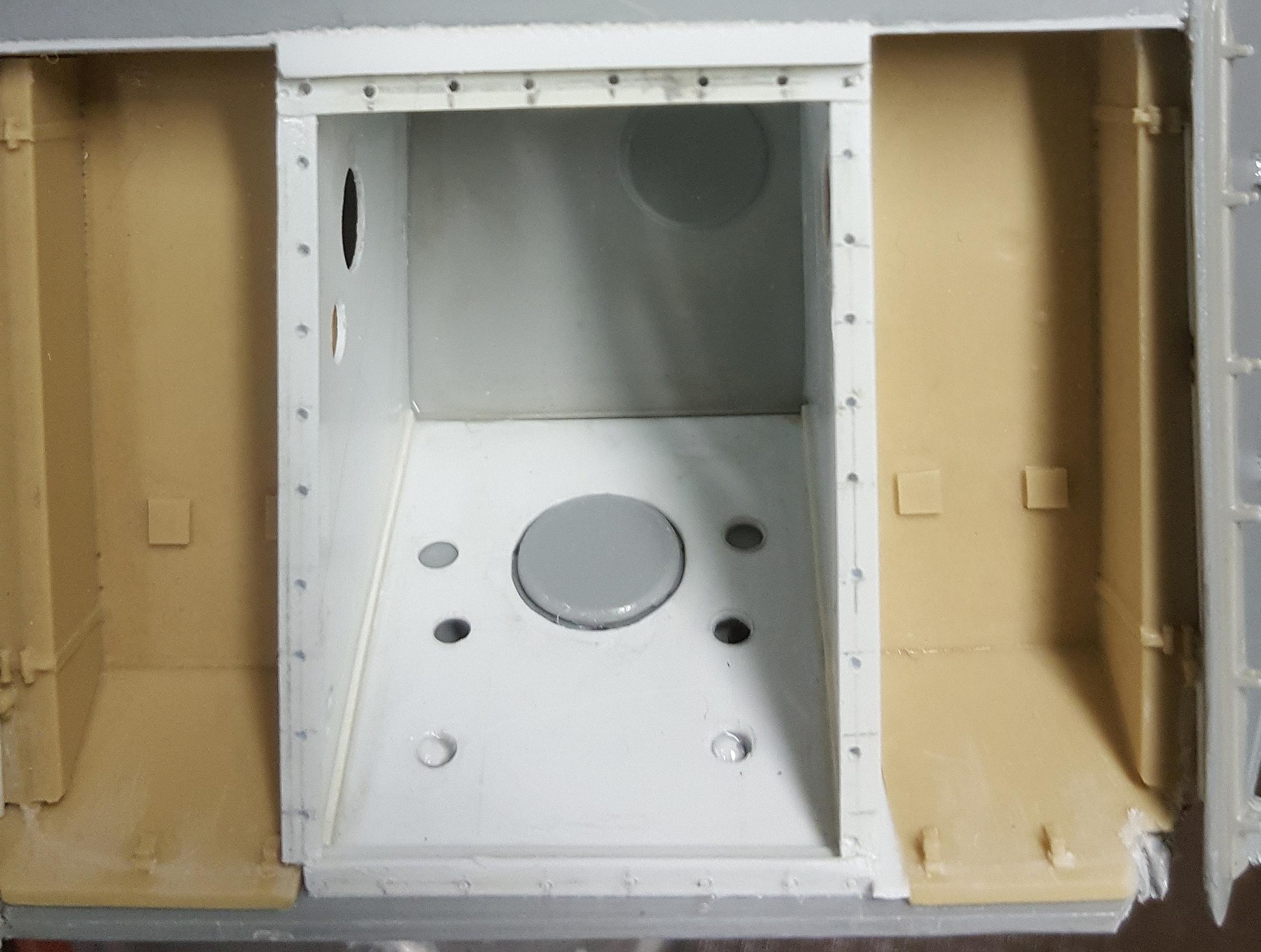

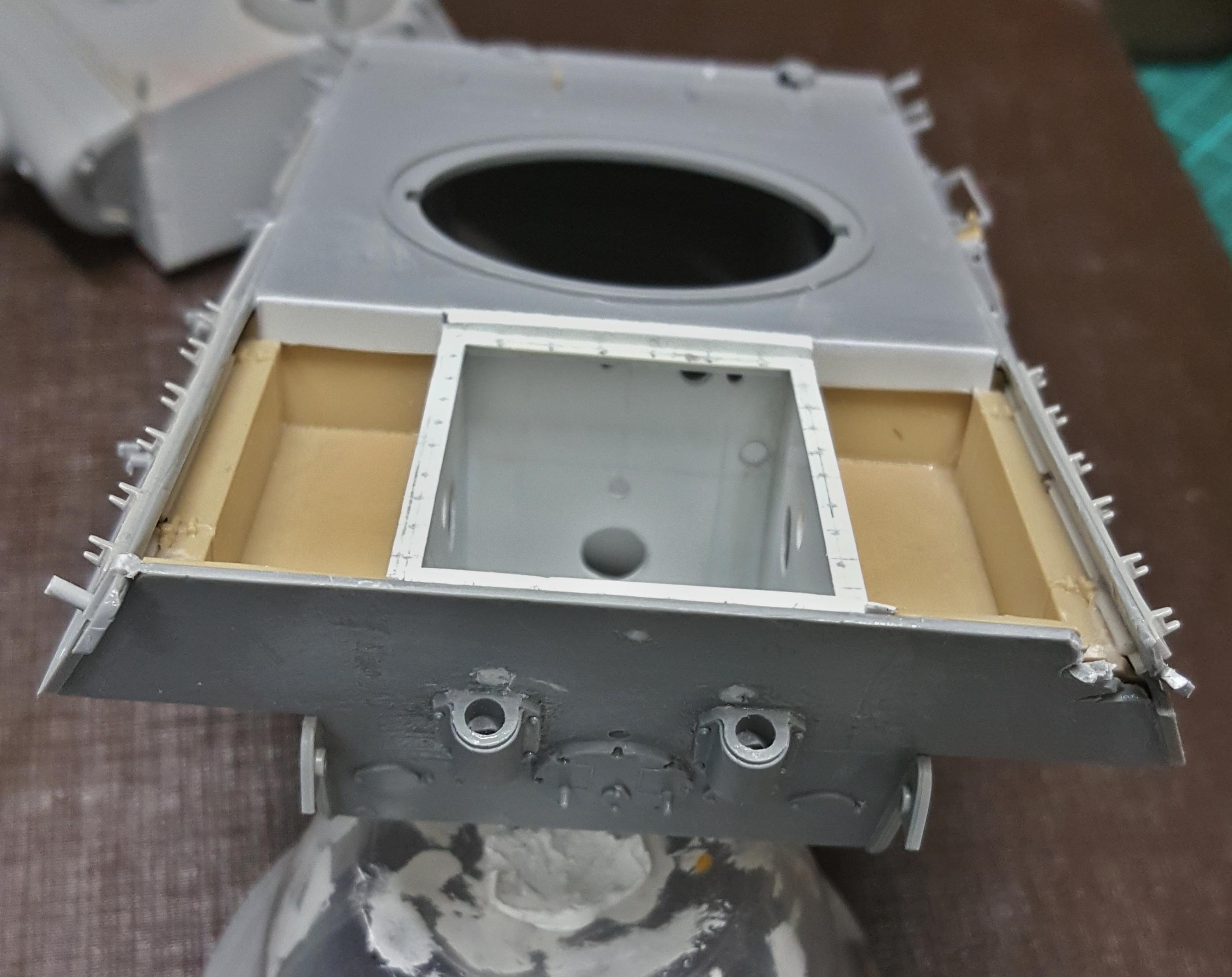

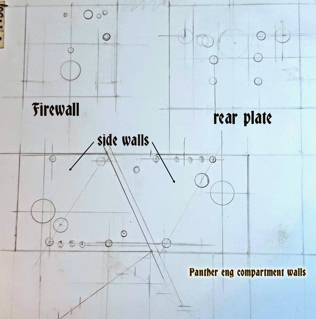

Another small update ; scratching-up the engine bay with sheet plastic. The VP update I had did not have full side walls.
Its a very quick draw up and a bit rough but it will be half filled with junk and rubble anyway.

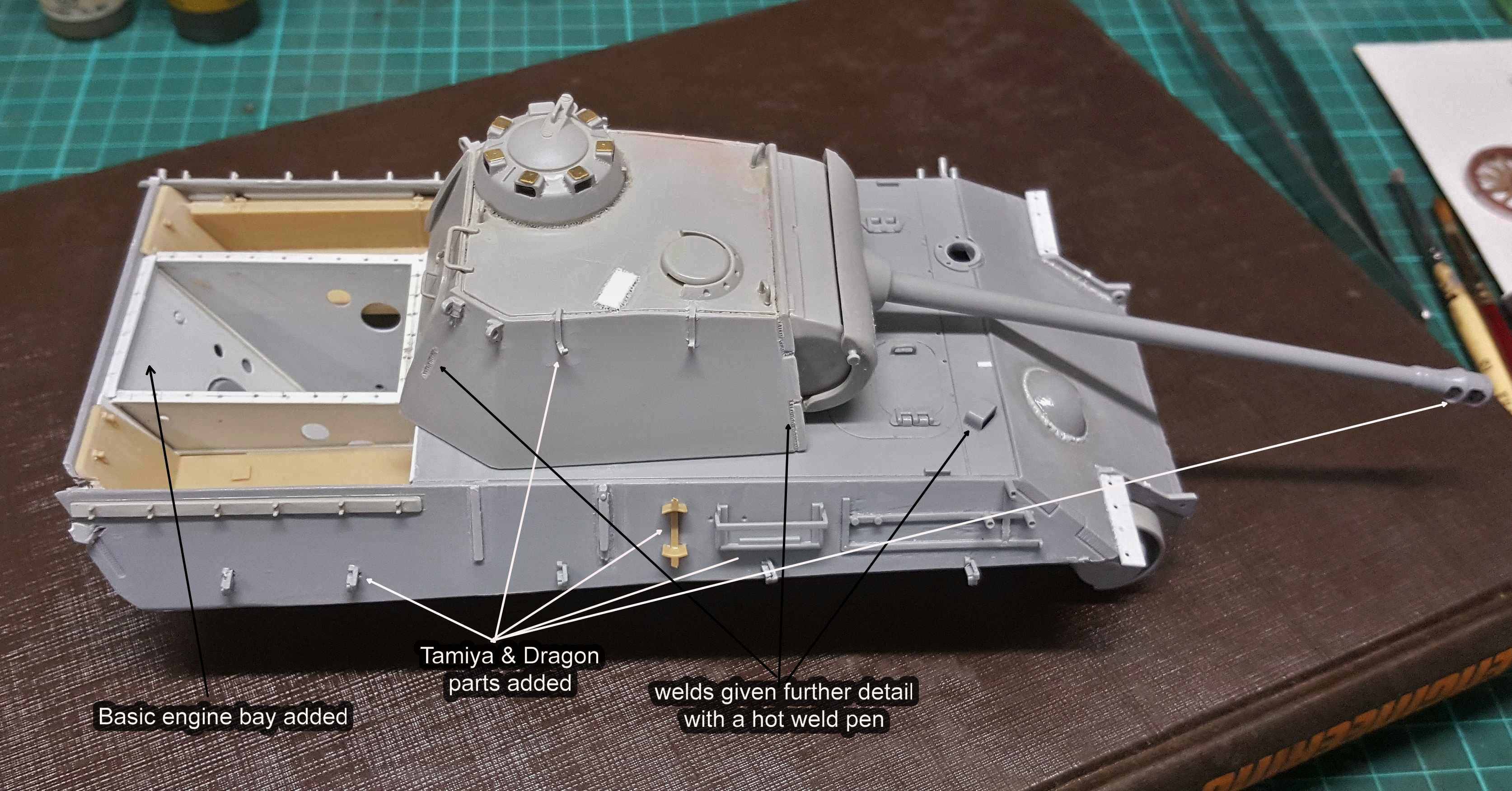

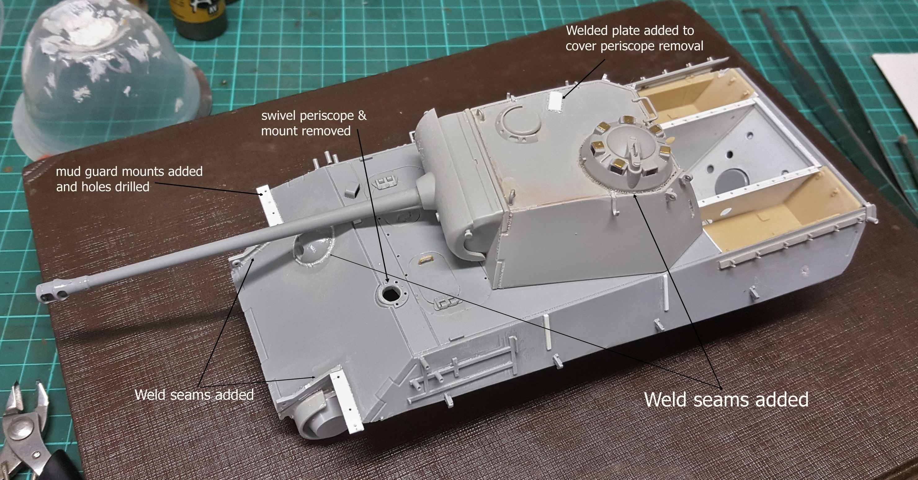

Another Covid Update.........

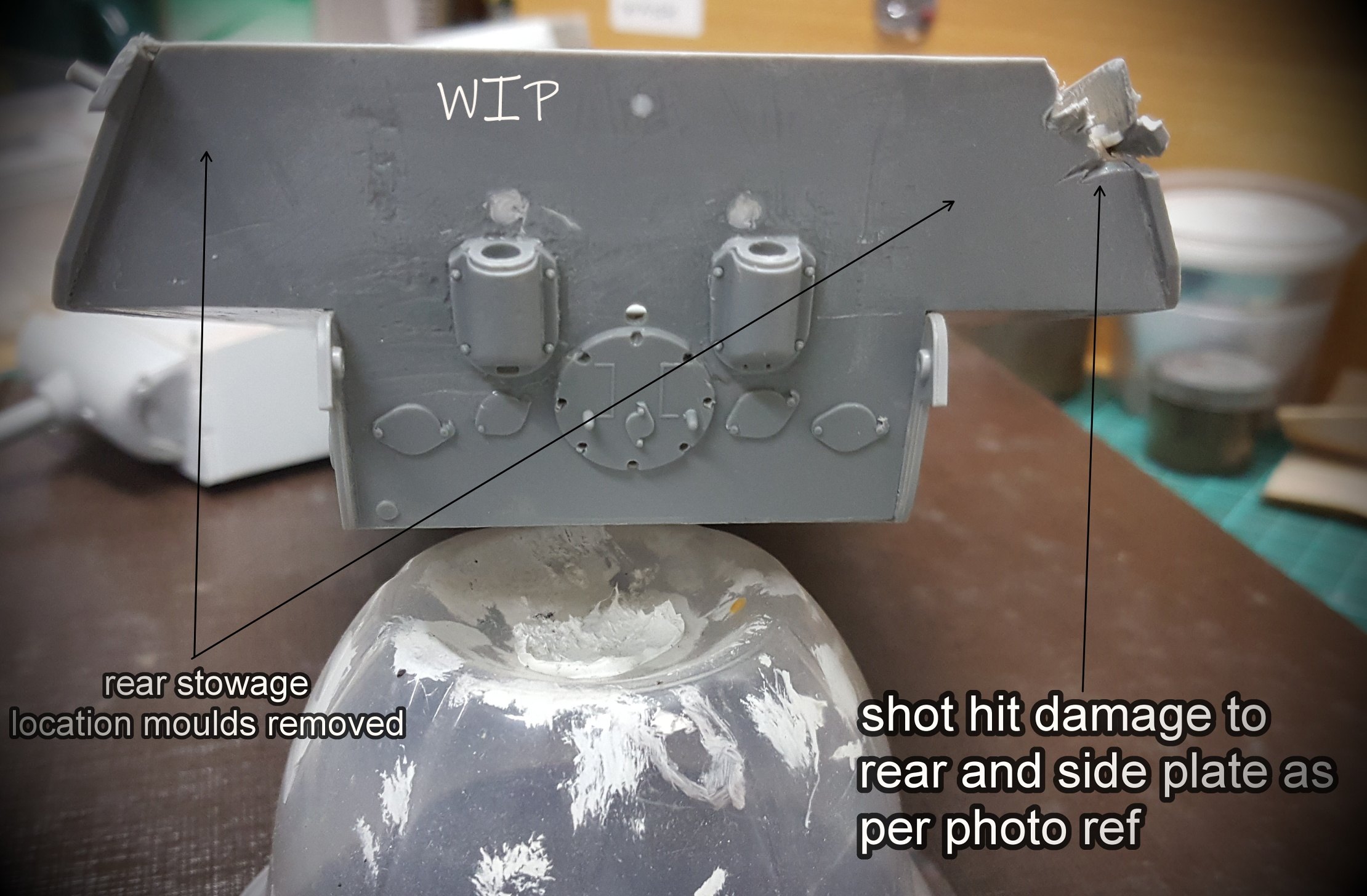

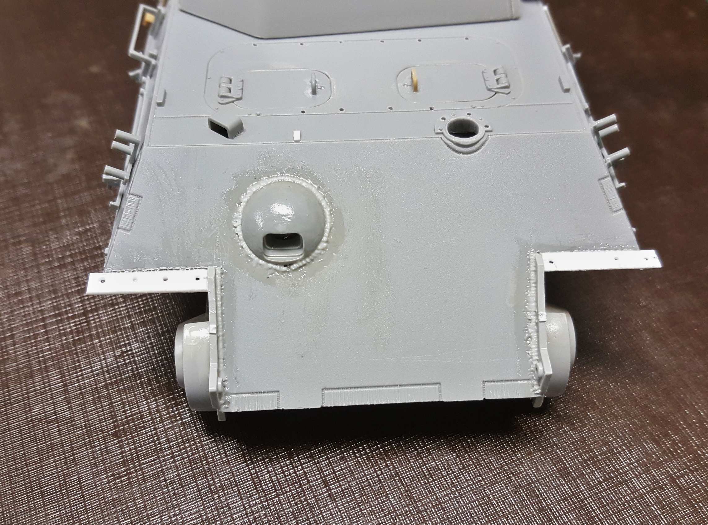

still in progress on the mods with a few more weld seams to enhance and some more rear damage to the backplate. I added the exhaust outlet castings because I had some spare and i thought that they would add a little bit more than a flate bare plate.
I also added the circular lfting hooks to the top left and right rear turret plates , my interpretation anyway of what I can see in the photo.
