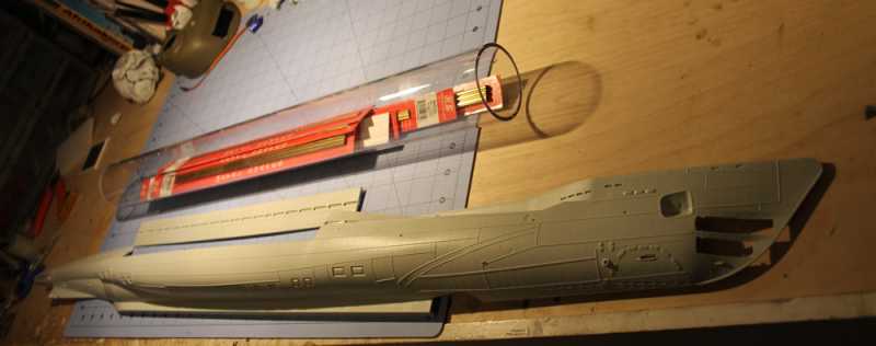

I'm using the new 1/72 Revell Type IXC/40 as my model. A, because it's new and available at a good price and B, because it was the first Snort boat, using a snorkel to be able to run underwater on diesels. I'm too scared to go compressed gas, etc for full depth diving, I'm going to stick to going just below the surface so if everything fails, I can at least locate/recover the thing.
Here's the hull half, I already cut out a section for access, and the Lexan tube that will house all the RC gear, motors, pumps, batteries, etc. A lot of brass rod and tubes, O rings, Cup seals in my future. I'll need to create water tight end caps and a housing for the tube.
By accident, I got very lucky. I ordered the tube before I had the kit thinking there would be plenty of room, but there isn't, it just fits. And again, by dumb luck, Schedule 40 2" couplings just barely fit inside the tube, so with some routing and sanding, I should be able to get O rings in there nice and snug. Since the tube and O-rings cost as much as the kit itself, not only did I dodge a bullet, but I couldn't have chose better if I actually knew what I was doing.
Wish me luck, I'm off to open a couple of hundred holes in the hull, just like the real thing...
