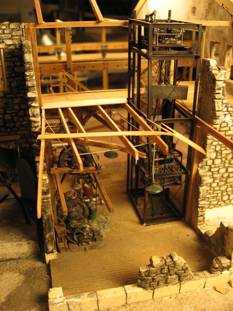

Anyway, work continues on the damaged side of the factory......

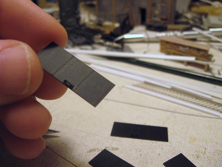

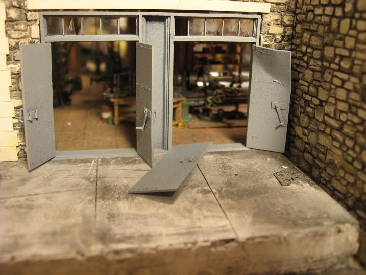

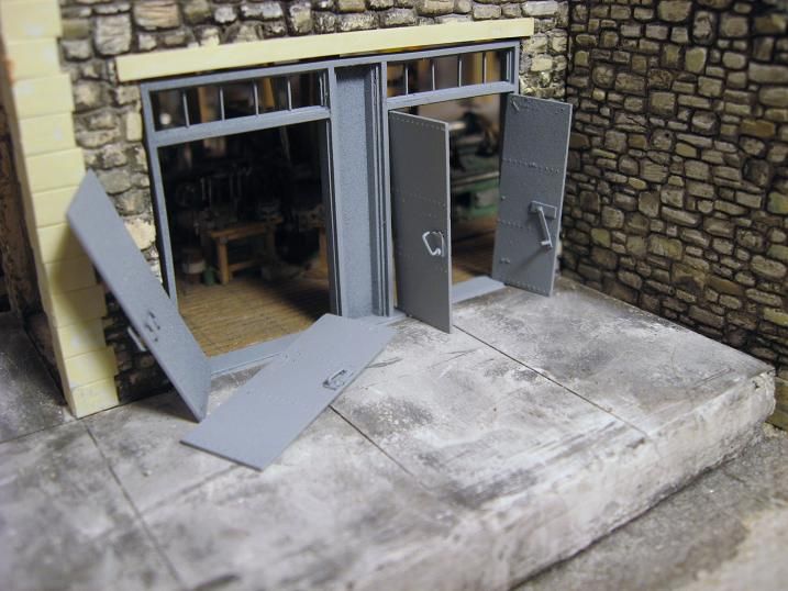

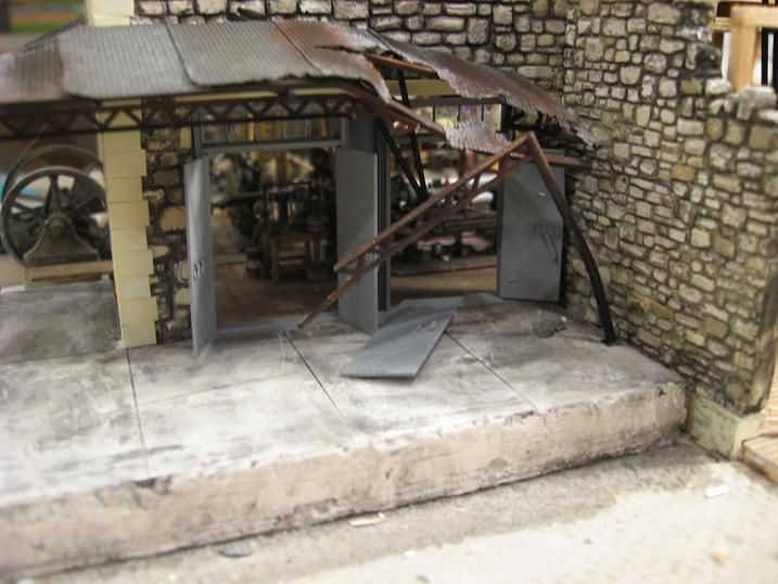

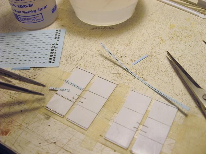

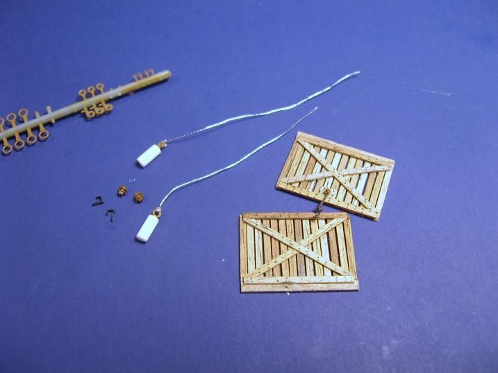

Doors for the loading dock area built up. Using the Archer rivet strips on this...
Tried for some damaged glass here but hard to see it!!
Not the final postion yet but will add some hinges and be done with them..

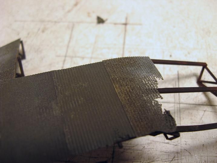

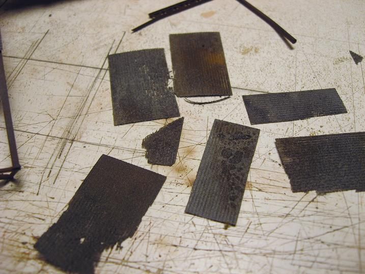

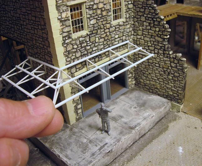

Next up is the roof over this area, going with corregated iron with a metal frame work....

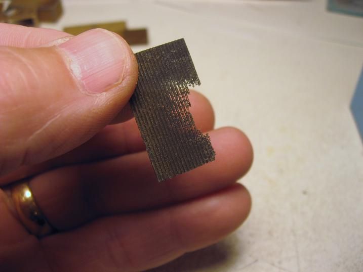

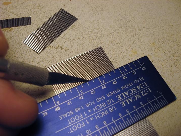

Using some Campbell Scale Models roofing sold as 'HO Scale", scales out to little over 3 inches peak to peak on the ridges....

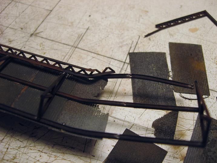

After cutting into sections I dip the foil into an etching solution...
This give some interesting effects to the roof pieces but I don't know if I'm real happy with it yet. Will leave it for now ...

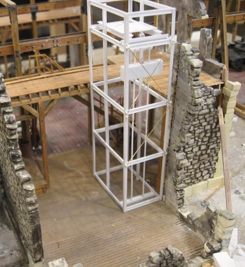

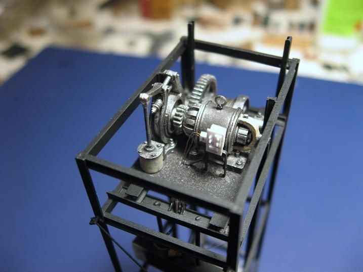

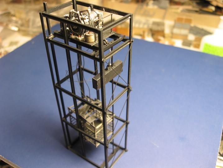

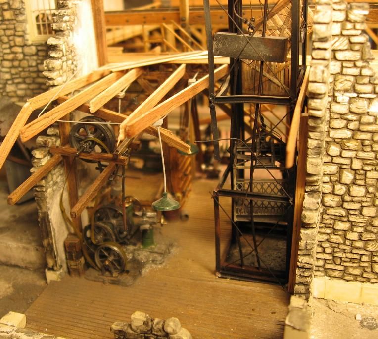

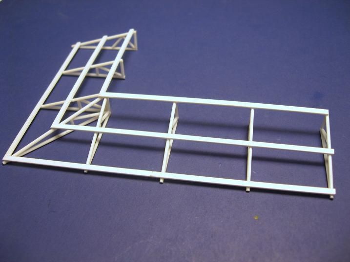

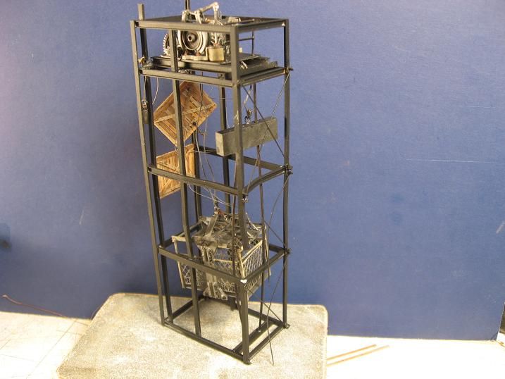

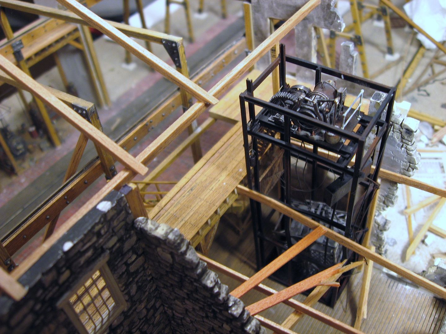

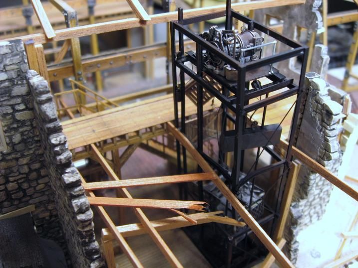

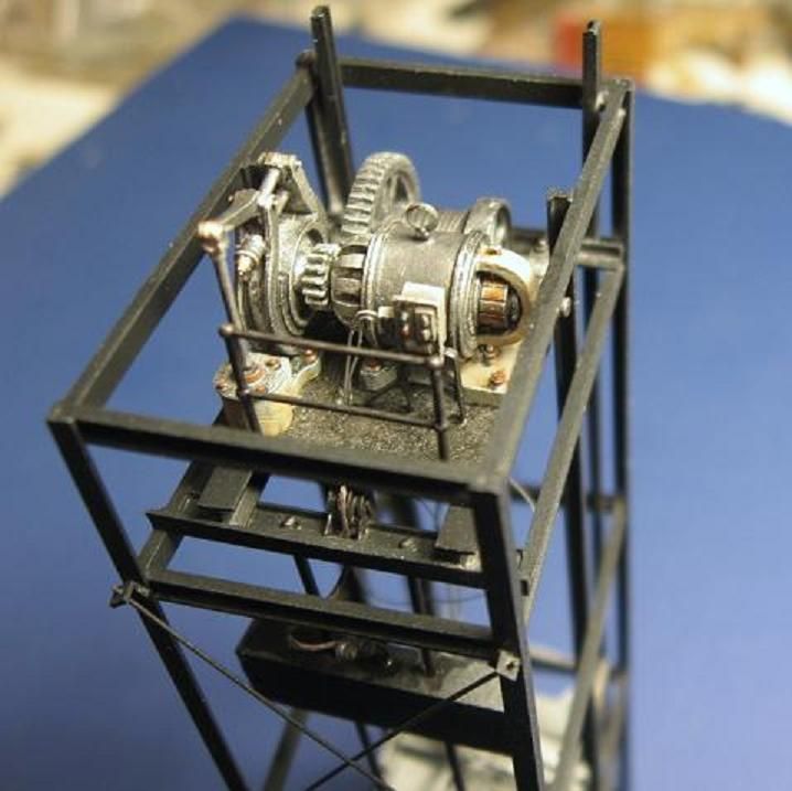

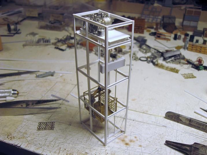

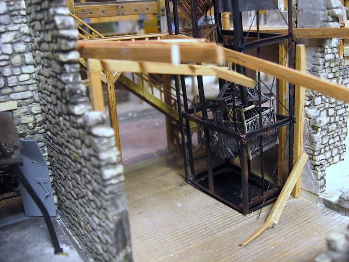

Next up is the small lift that travels between floors....

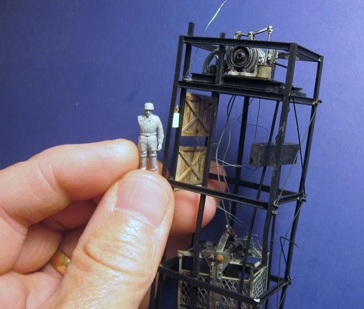

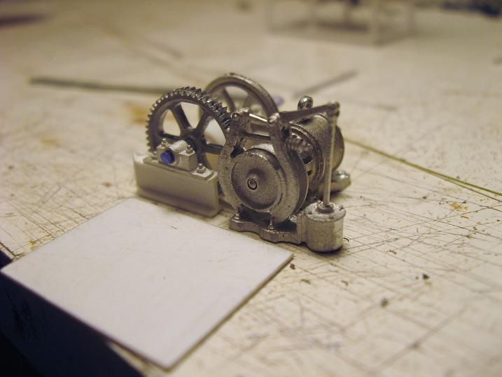

The framework is styrene and the winch mec. is powered by an electric motor.

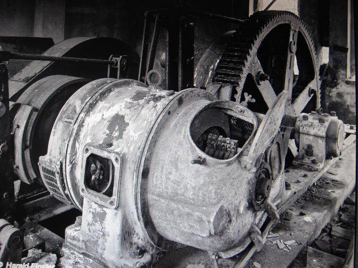

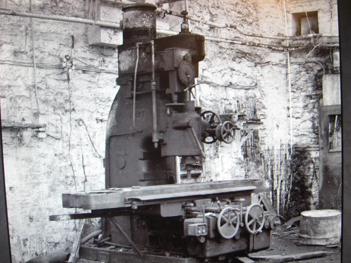

Found some great reference pics at a German photo site called 'StahlArt'....

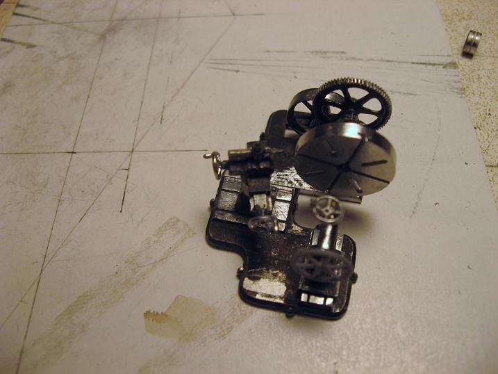

My version are white metal castings from the train spares box.

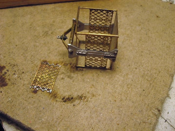

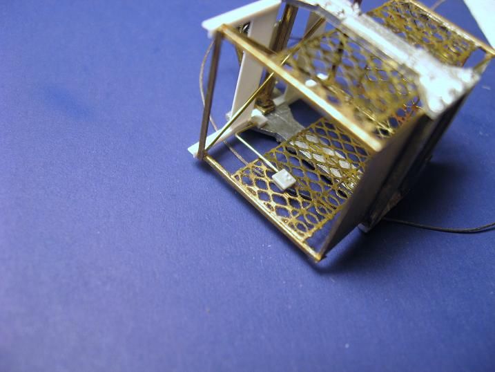

The lift cage is some etch soddered together along with some plastic and white metal bits...
Need some doors and conter wieghts.

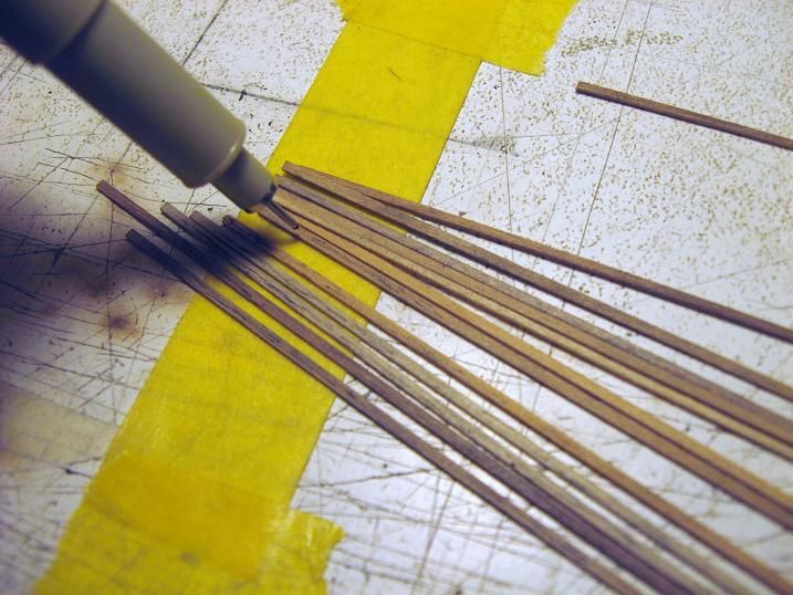

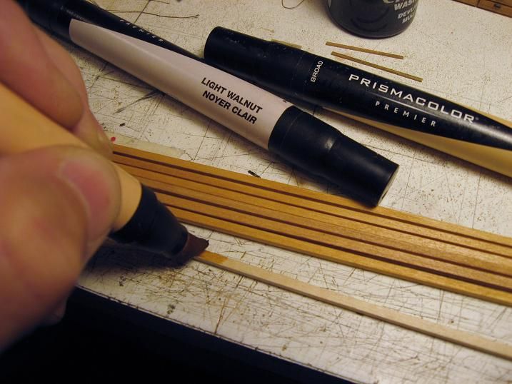

A quick note on the wood used in this project. I t is basswood that is 'stained' using art markers. I prefer this method for unpainted wood (very neat and quick drying)
In this scale I think any attempt to crave in wood grain comes out 'over scale'. I like to use a .0005 drafting pen to draw in the grain...

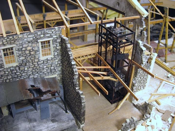

Now it needs some damage...
