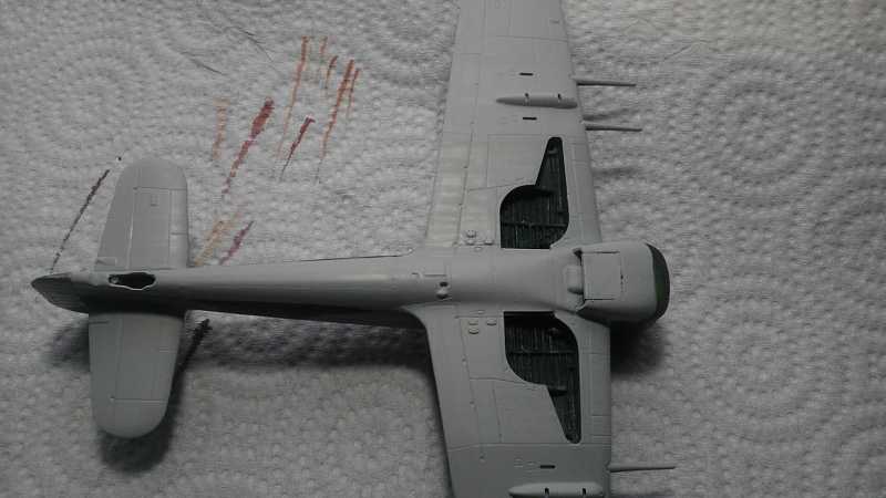

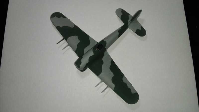

I put some paint to plane today but have run into a few problems
even though the plane was washed throughly the vallejo paint is fragile and is lifting and flaking even at the softest of touches
Ill see how it goes but I may have to strip and tamiya it instead
Heres the pics

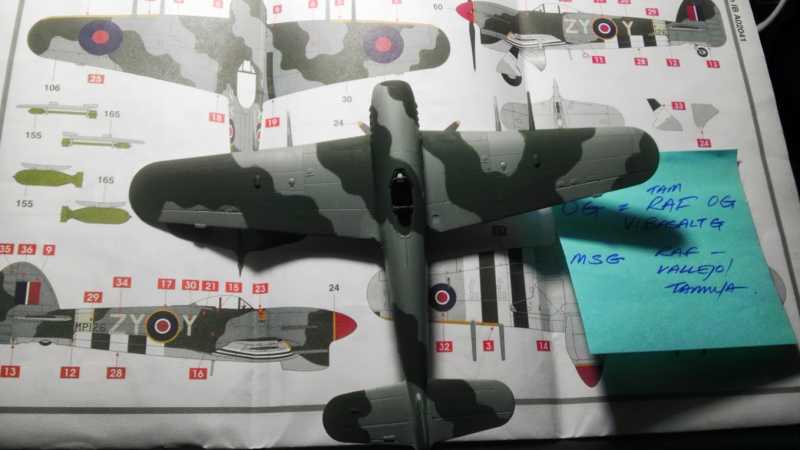

Just a quick guide to the kit instructions to get the basic shapes going
Another shot

guessing you didn't have a primer Andy? Vallejo really sticks well to a primer. It's looking good but be careful!
Andy, the paint job result is good (y)
But, if was my build I strip the colors and apply a Primer (Vallejo has good ones in very diferent colors)
Primer sell at Lucky Model or from Tamiya or Humbrol (wich must be easier to find in UK :hmmm ). To them repaint the model the find a better finish. :eek:hyeah
Just a suggestion lad...
Cheers :drinks
Art
Thank you all,.. Yes on hindsight I should have used the primer as the Airfix plastic has quite a waxy feel to it
Ive removed the yellow stripe now so I have the option to go down the strip route or continue being very careful and varnish the plane instead
Decisions decisions
Andy, I prime everything with Tamiya primmer . Acrylic just does not stick good to bare plastic.
I use the Vallejo primmer on small places that will not require further work.
Cheers, Christian B)

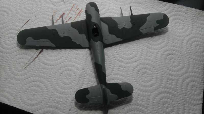

Quick update with some painting refinements
Gone over the sea Grey
Better shaping of the green camo
Just leaves now one more coat of the topside sea grey to finish of the painting stage
