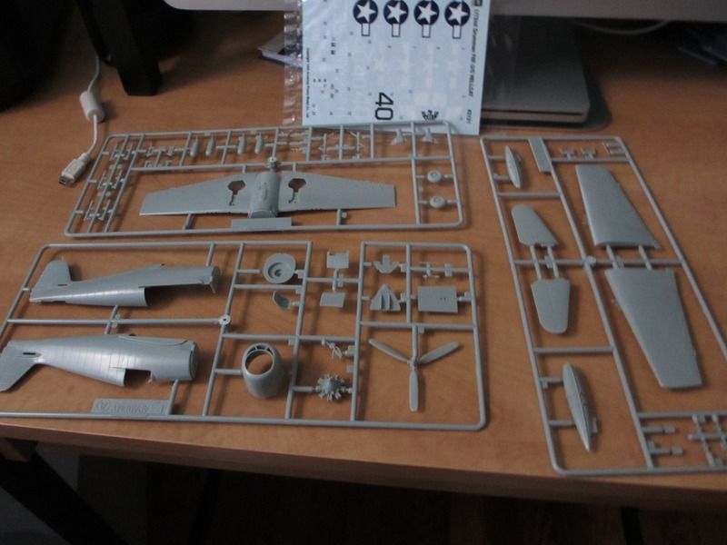

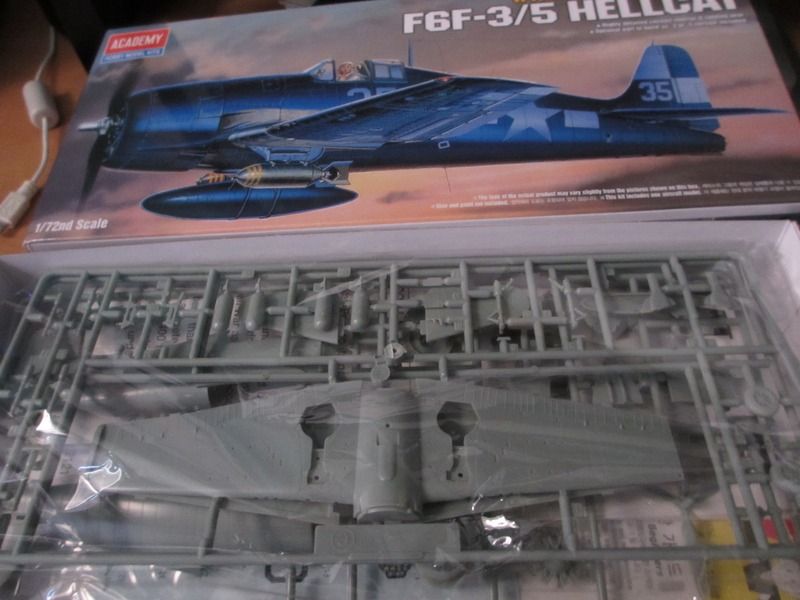

After a false start on the Sea King, I'm going to re-up with this submission. from the looks of it on the sprue it should build up a nice little model and not suck the life out of me building it. My hope is to get this one built in pretty short order and back it up with something else as a companion build.
So here we go with some start up pictures......
I'm hoping to get a start on it today so maybe i'll have something to show shortly.

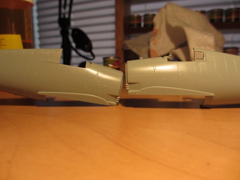

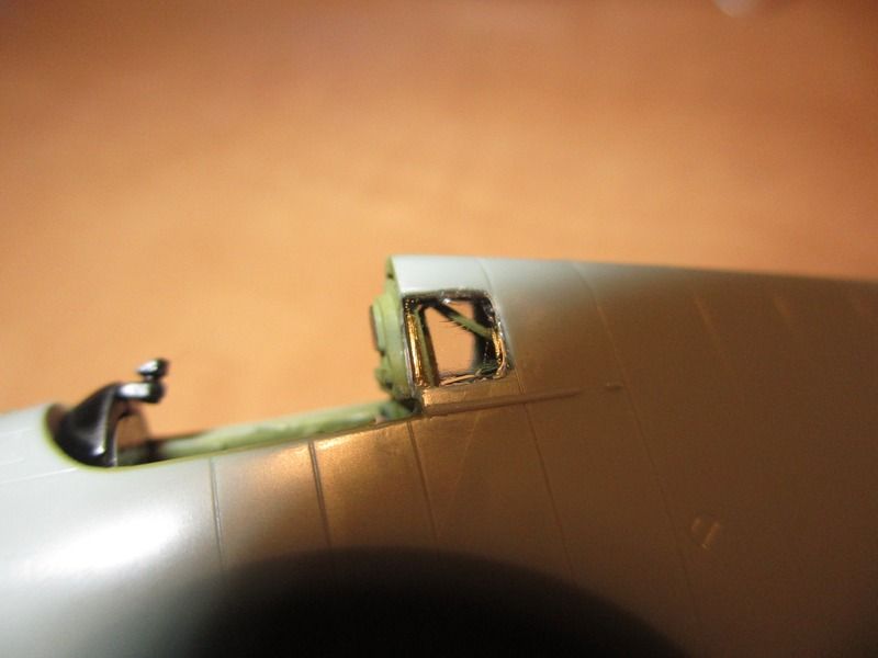

I made a start! Got the turtle back windows cut out and installed. I used Future as an adhesive to hold the clear parts in place. after a couple of hours to cure, I went around each one with a very carefully applied bead of CA. Then let that cure.

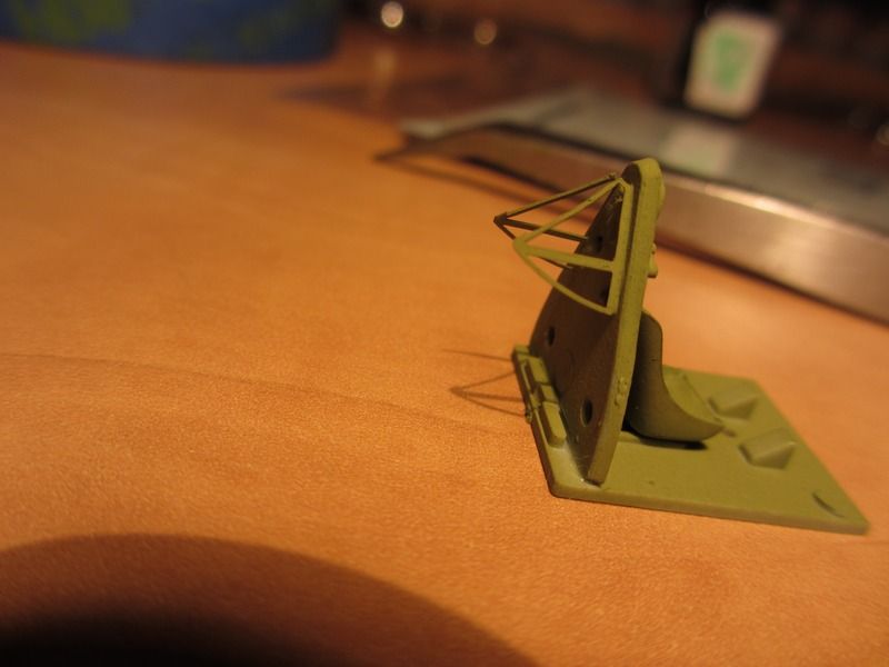

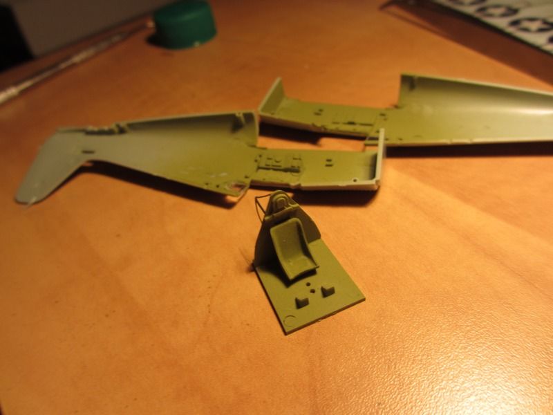

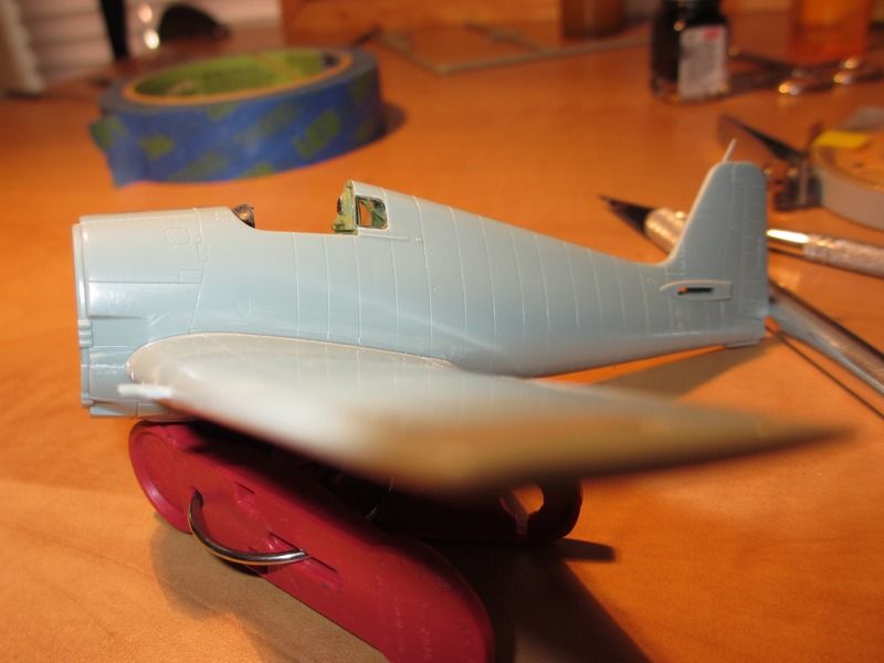

So while that was curing, I jumped into the basic pit assembly. There's not much provided in the kit, so this went pretty quickly. One little addition I made was to the armor / bulkhead behind pilot seat. There are these diagonal support struts, no one ever sees these on the dash 5 because the quarter windows aren't there. But on The dash 3 model they can be seen, so since the pit is so basic, and It just so happens I had some scrap PE.... I made that little adddition.
I don't think a lot will be seen once the fuselage sealed up so Im not going to fuss too much on it some paint and a harness and I'll be moving on.
Very neat technique. Never read that before. Now I know how I'm going to winder up my Sharkfin B17. :pilot
Well Bob, I kind of pulled that out of my A$$. I used that trick way back on my Sunderland build. Lots of portholes and i didn't want to punch them out during masking, so I gave it a try. Future the clear parts, let it cure real good, and go sparingly with the CA. It does probably help having the fuselage in halves to keep the fumes from building up.

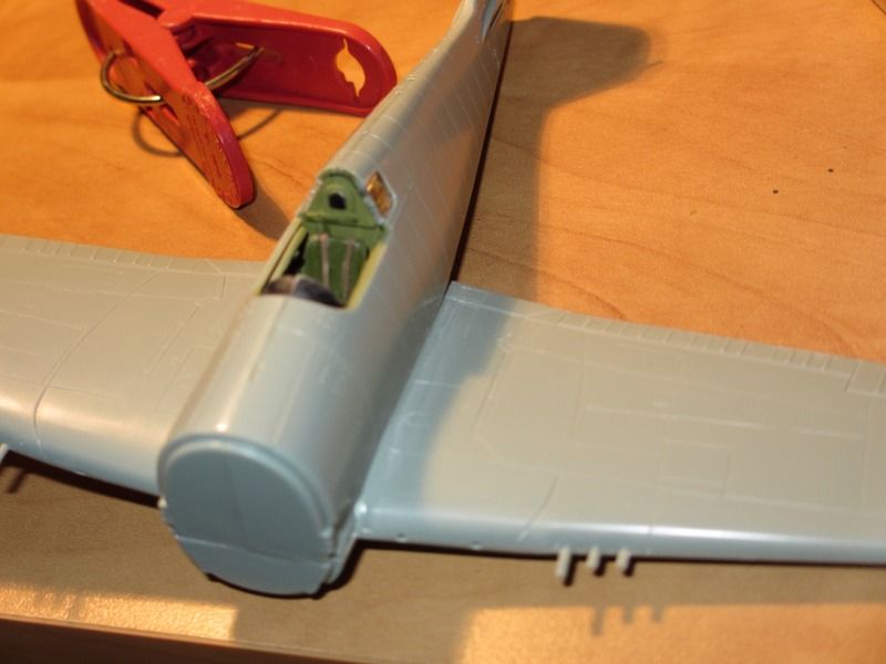

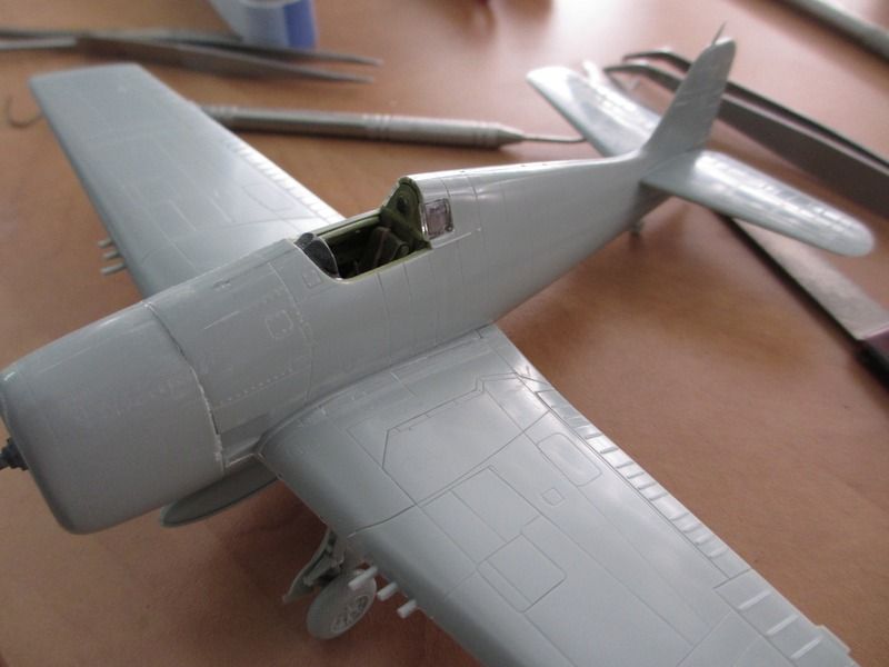

Anyway the cockpit is in and the fuselage is closed up and the wings are on! I'm pleased that the little bracing struts do show through the quarter windows. That's all I'm going for today, the honey do list is need some attention.

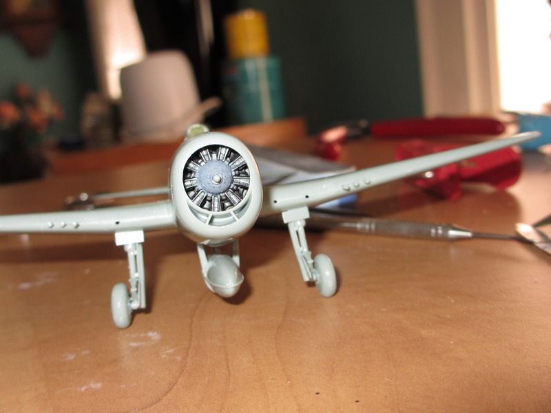

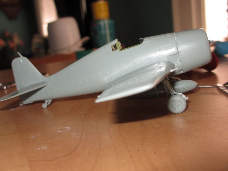

On a more positive note! I actually sat done at the bench and did some modelling. I think it's about ready to head to the paint shop. Here's a trio of pictures of the little cat as she sit up on the landing gear.
I'm hopeful to get some paint shot in the near future.
Thanks for looking and really thanks for the good mojo.....
