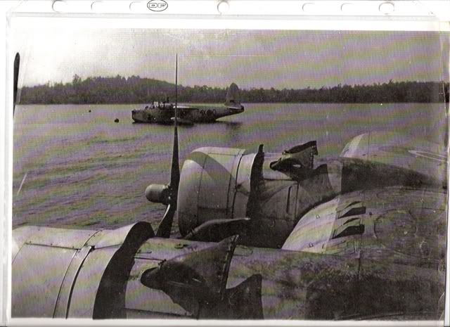

There are a few corrections that could be made if you wish to go that route.
1. The diagonal lines on the upper wing fuel tanks can be filled, they represent reinforcing that was only on the Mk I/II.
2. The centre porthole of the three along the wing leading edge on the right fuselage half should be filled.
3. Still on the right fuselage half, a 10th porthole should be added at the front of the lower string of 9. This is also required on the Mk I/II kit.
4. The Oil Cooler vents on the upper wings had defelctors installed on Mk III's. Like these as seen on a Mk V.
5. If not displaying the bomb racks deployed, the tracks in the lower wing should be filled as there were strips that moved with the rack to cover them.

Great info and picture :D Who know, it's not to late to succumb to insanity and buy one. :rotf
Cheers, Christian B)
Thanks for the info Rich , it should prove helpful!
