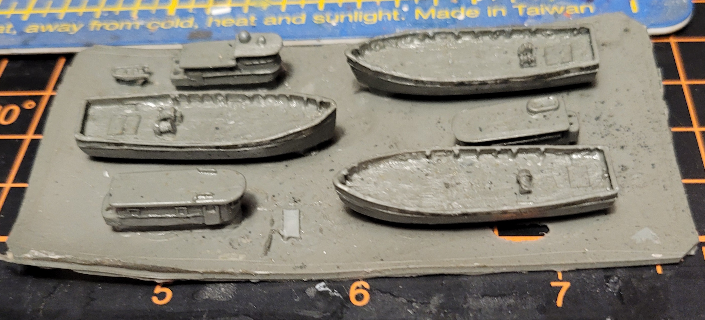

I consulted Eric at Reynolds Materials. We had some of the same ideas. I'll confess to rushing the mold, and trying to pressurize 2 at one time. I thought about casting the 2nd mold again to see if it was a mix/ratio or temperature snafu. Eric thought using a little less red activator would increase the viscosity of the RTV mold compound, allowing offending air bubbles more time to escape as well. (My scale could be a little less than precise) He's a molding/casting Jedi!
Try, try again! This whole model kit making process is very educational! :bang head

Yup. The castings "mirror" the mold. I thought I might cast the 2nd mold inside to see if temperature had anything to do with it.
New, revised resin parts! The 2.0 mold worked in a stellar fashion!
