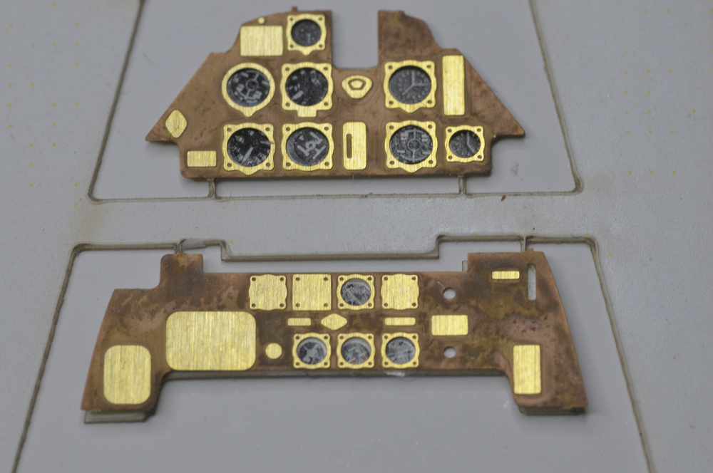

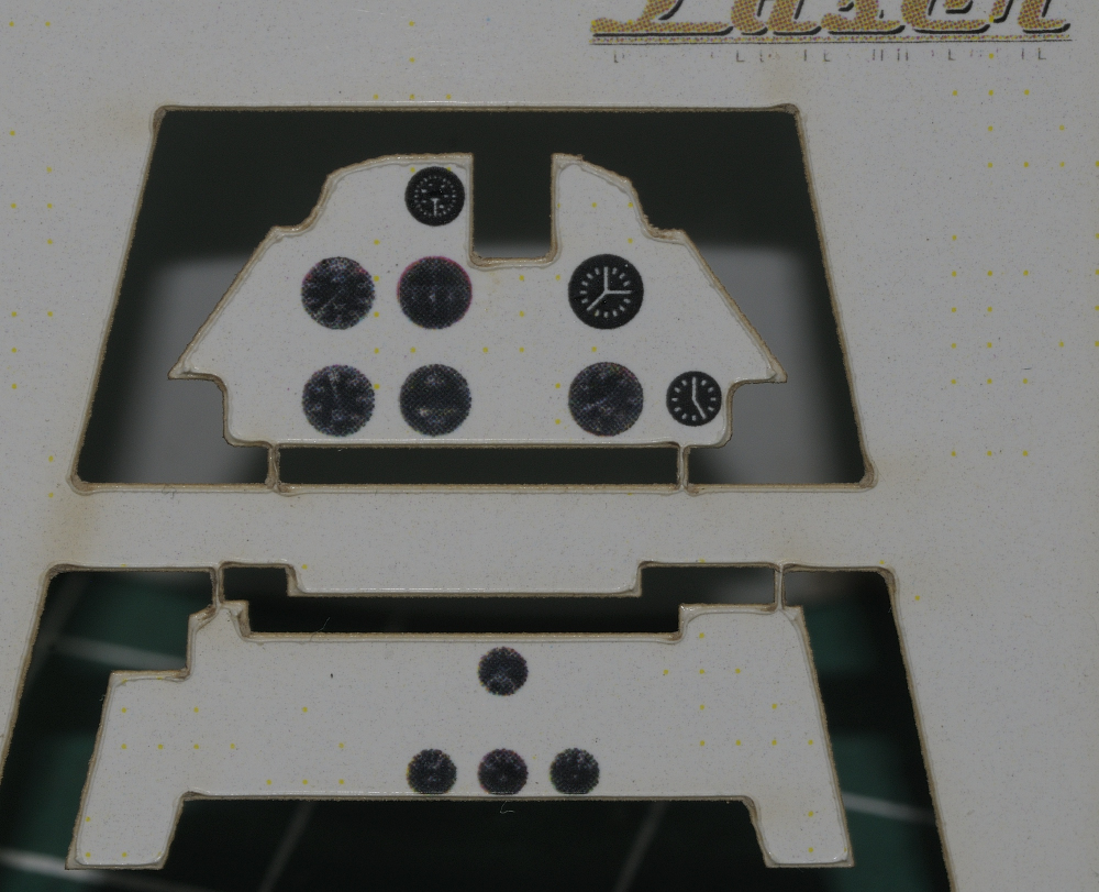

First up was the instrument panel..
The kit part is nice but its quite small and the kit doesnt include decals for it. I decided to buy a PE set but this was pretty poor as well. Incidentally although marketed as HGW, once unwrapped its all marked Eduard.
The dial have not been printed very well... or at all in :) I did comment about this too #Hannants and they said, they had looked at the others in stock and they are all the same but it wouldn't notice on the finished model.......well if it wouldn't notice, why sell them :) They did in fairness offer a refund.

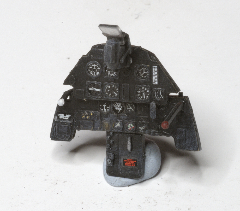

I gave it some thought and i have some individual decals from airscale so i decided to use the parts above as a template and simply put new dials over the old and then give them a coat of future to fix them...
First test fit showed......i had got some dials all crooked and some just didnt line up.lol :) Come on Paddy, pull your finger out ....
Anyway the 2nd attempt has worked and i now have a passable instrument panel
Bit rough round the edges but that is intentional

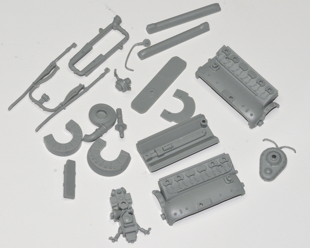

Next up i am looking at the engine. Again i could buy an Eduard high detail effort but i have found that although they are very nice there is usually some consequences, ie: never straight forward. So lets see what we can do with the kit parts and save a load of Dosh :cool:

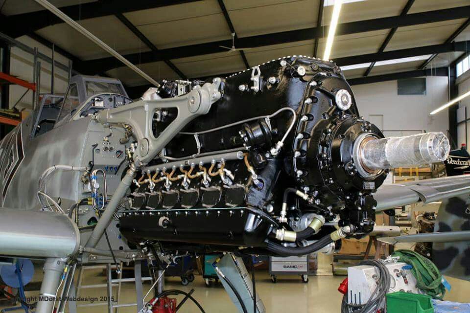

this is what you get, its pretty comprehensive so i am off to google Daimler-Benz DB 601
Probably best not to mention it but i think they have put this in upside down :)

Passable?!! Your idea of passable is very similar to my idea of spectacular! That looks frikken awesome my friend.

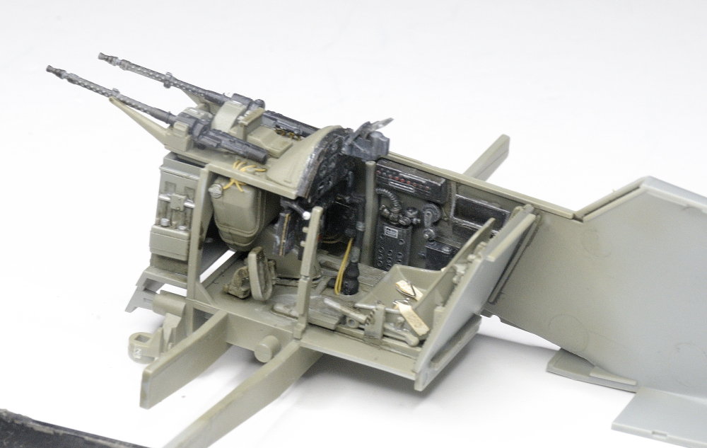

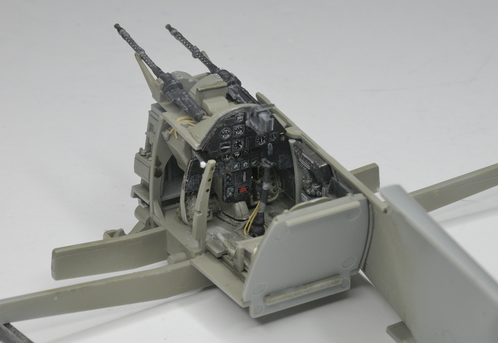

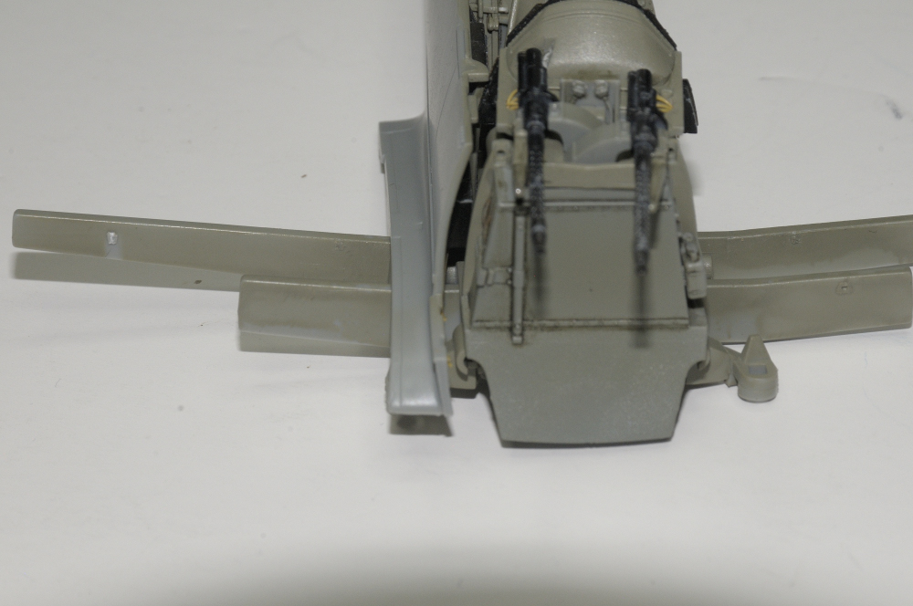

I have chickened out of the engine while i try and think of a way to improve it without after market. so
this is the Pit. Its just balanced together here as there are a few problems.

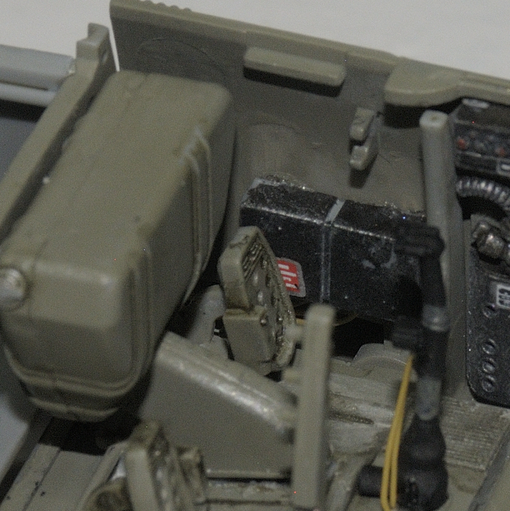

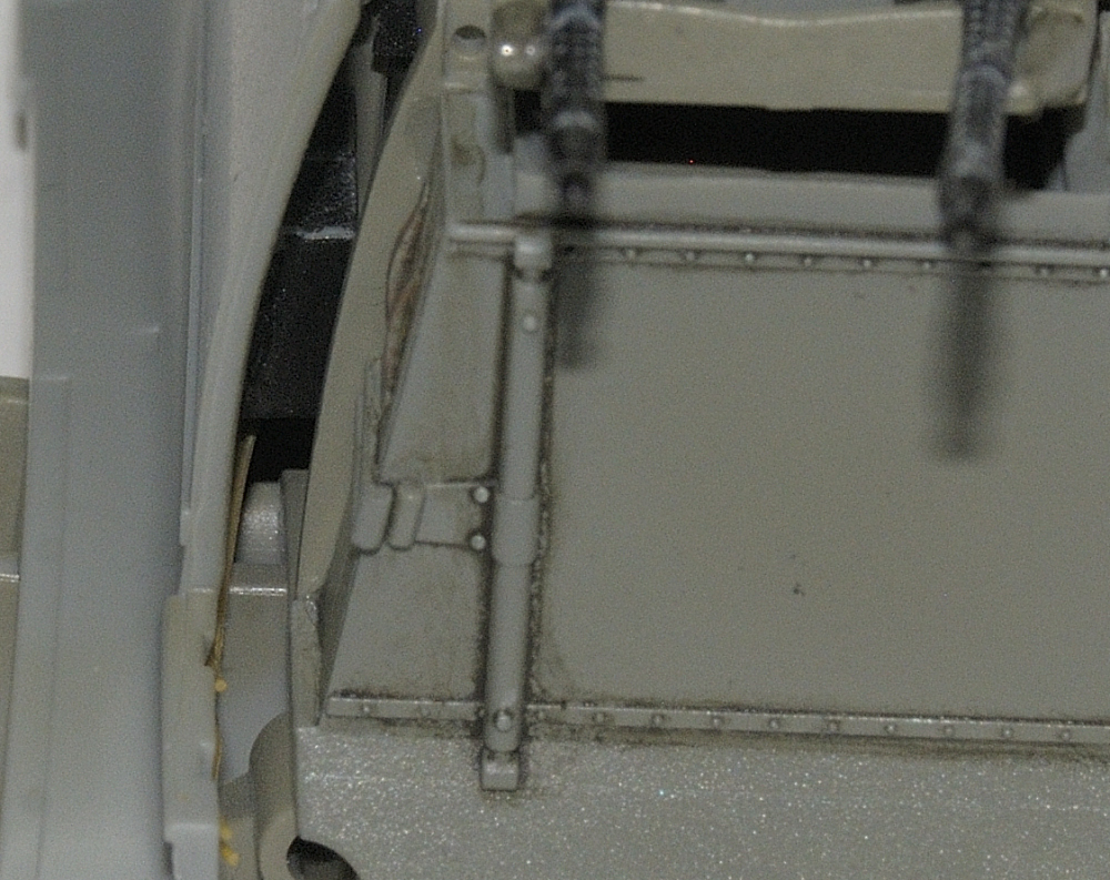

The first problem is the rudder pedals foul a box on the side of the fuselage stopping the whole ting sitting in place
You can see here the rudder pedal up against the offending box.
may be just remove the box, its not going to be seen once its all buttoned up. I just wish someone would test build these things before they go into production, especially when it goes into production for a second or third time with a different manufacturer. I am also told the fairing panel over the guns here is a well know problem on this kit .... no excuse for this sort of thing really.
To others building this. The cockpit section above involves a lot of parts which have to align with others so you have to look ahead, dont follow the instructions sequence, you will end up ungluing parts to fit others that should have been fitted first. The cock pit assembly above does not include everything called out in this step. To fit those parts now like the lower wing centre section would make the chances of the whole assembly then fitting well between the fuselage side pretty unlikely as they would be too many contact point that would have to align.
Its not a major problem but be forewarned.

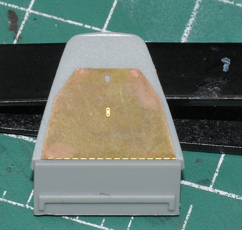

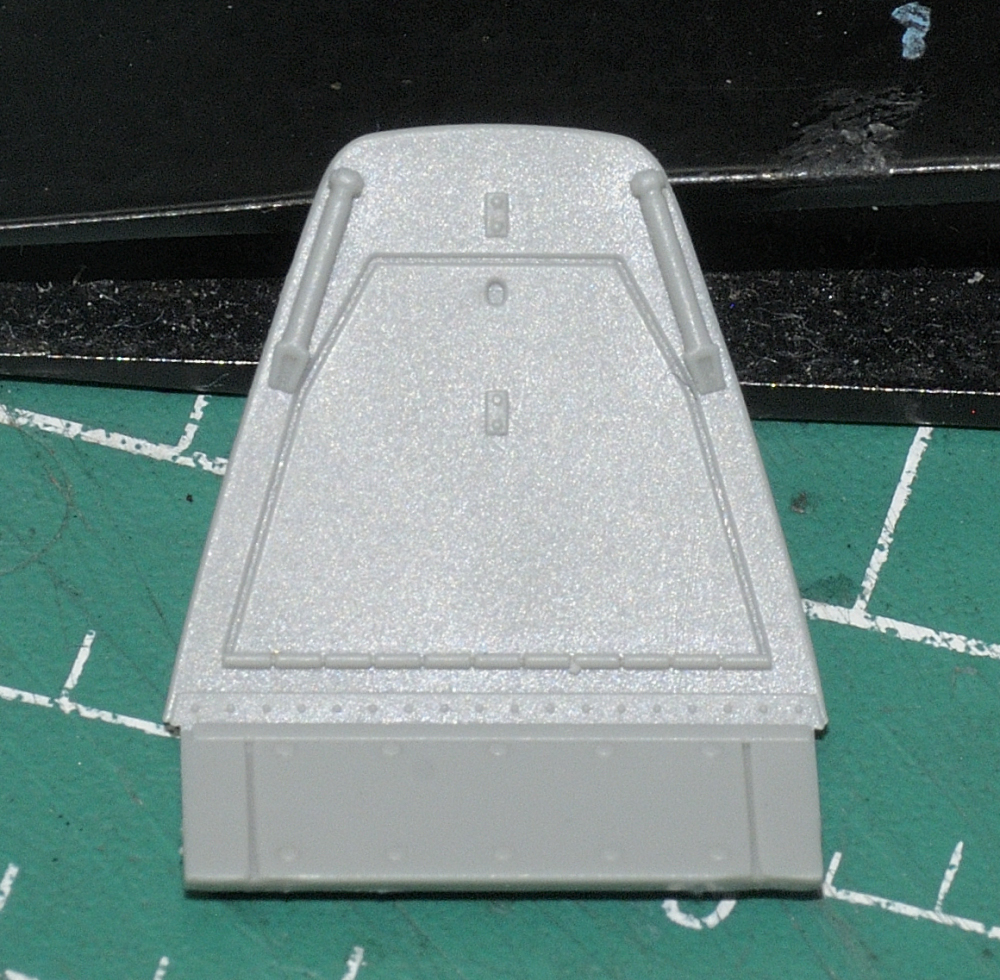

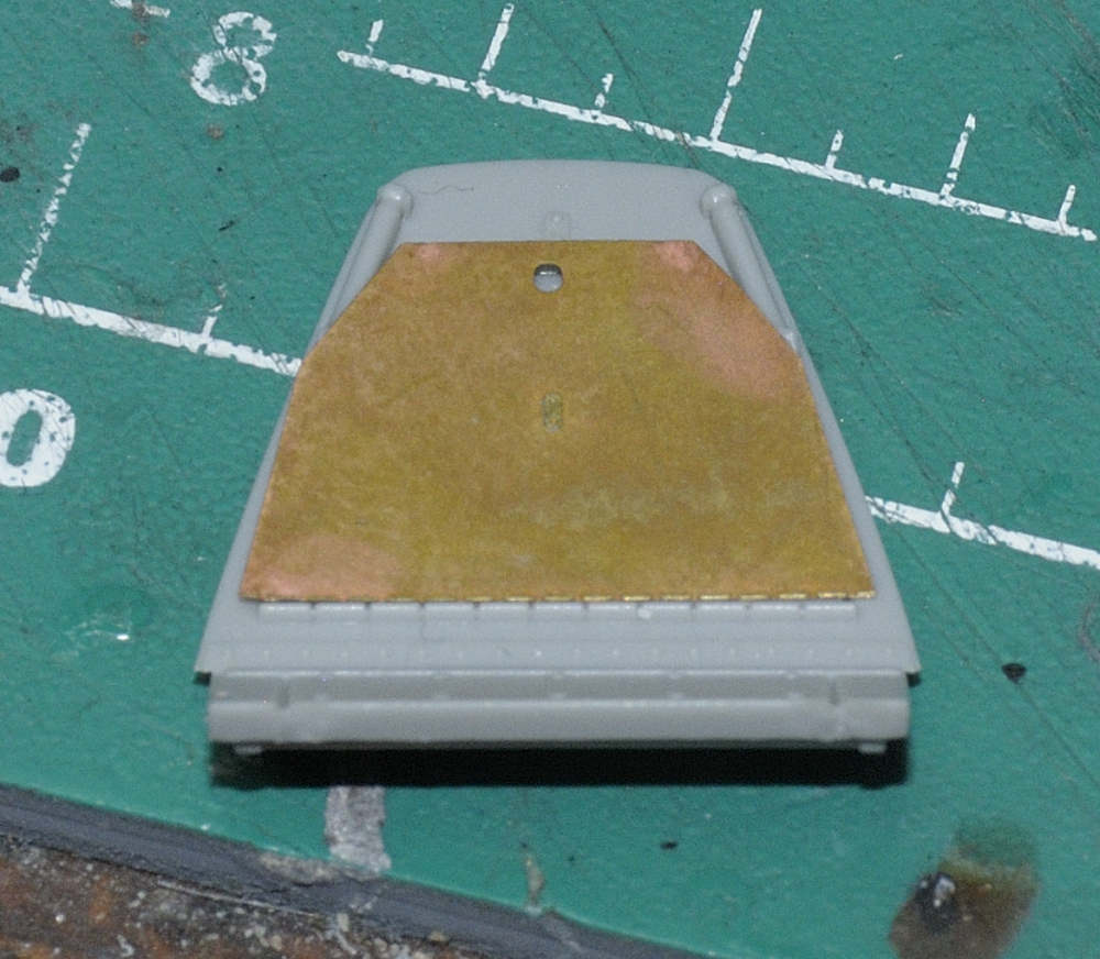

This is the Eduard/HGW armour plate for the rear of the cockpit
as you can see it fouls the protrusions near the top ,,, but hang on, it looks out of shape anyway ?
here it on the back of the panel as its flat. The angles at the top are not symmetrical so its always going to look wonky

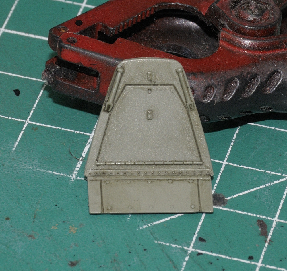

Scrap that then.....this is the kit part
and painted...who needs PE anyway :cool:
