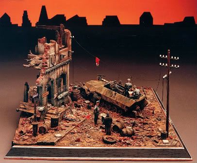

• A lamp post can work at the front as long as it is skinny and is joined to the rear in some way(as in the shot below). Like via a power line for instance. This works but it is harder to pull-off and it depends on your subjects. This can be applied in many different ways.
• Never set your detail out in even quantities, as this doesn’t look natural but contrived.
HERE IS AN EXAMPLE OF USING A LAMPOST AT THE FRONT.

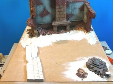

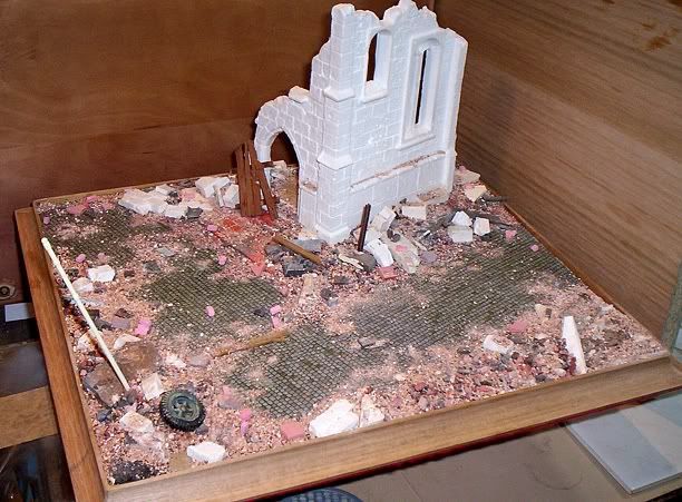

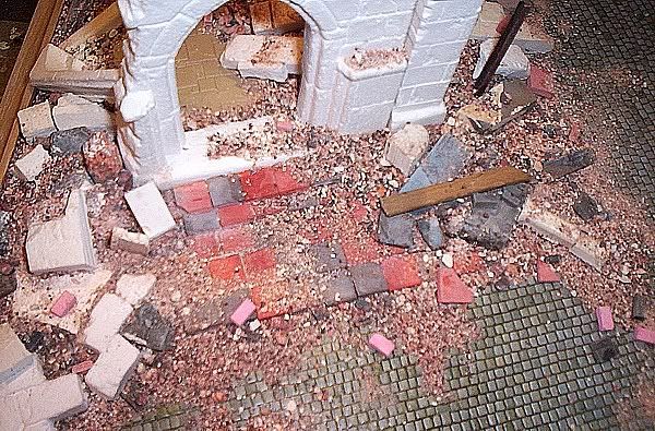

Now its time to make a wooden base and stick down your groundwork and building. I use a mix of white glue and water plus a touch of detergent so that it will flow over the ground work and not be held up by the surface tension. Please refer to my small base blogg. So this is what you have at the start. Nothing much to look at but it should still feel right and convey your detail and TEXTURE. YOU CAN TELL IF IT WILL WORK EVEN AT THIS POINT. SOMETIMES WHEN i HAVE PAINTED A BASE i LIKE IT SO MUCH THAT I DON'T WANT TO COVER IT UP WITH A VEHICLE.

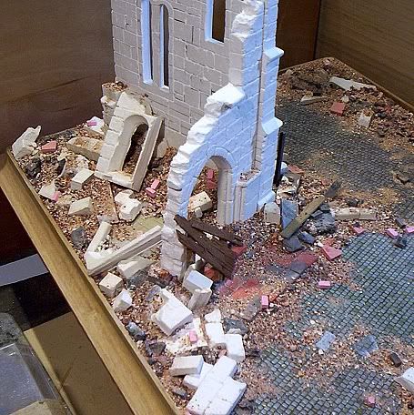

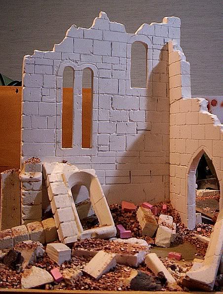

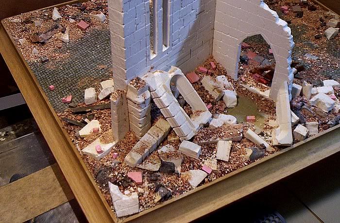

I rescribed the outer detail to make it more 3d and added interior detail, through scribing, to the inner walls. I also added broken stain glass window pieces cut from the VP release and cast up more broken pieces of rubble from the original.
YOU CAN SEE THE DETAILS AS WELL AS THE RESCRIBED INTERIOR. YOU CAN ADD SCRATCH BUILT STUFF TO YOUR HEARTS CONTENT. I BUILT A BROKEN WOODEN DOOR BUT I COULD ALSO HAVE ADDED WOODEN SEATS FROM THE CHURCH, UNDER THE RUBBLE.
I had to balance the rubble effect with reality so I went for somewhere in between. Not too much , hopefully ....just enough for visual effect without overpowering the scene. Too much rubble can wreck the whole thing.
I added some stairs as well. This can be really fun and very enjoyable. I enjoy this kind of basic detailing of bases as much as building the vehicle that goes on to it.

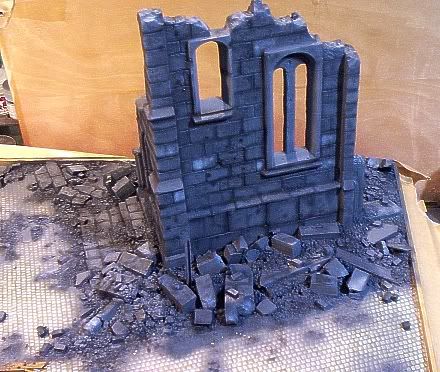

-I base coated the scene in a Tamiya Acrylic mix of German grey +black.

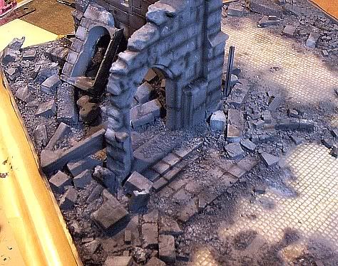

-Then I sprayed straight German grey but only in the middle of all shapes and objects, leaving the crevaces and edges dark.
WARNING - there are no short cuts for a quality base. This is a long and detailed process and I know not everyone likes to paint - especially groundwork, but you can get some great effects to match your vehicles with the same satisfaction if you look at it in the same way as your tanks.
I also oversprayed these crevaces and cracks again with Tamiya acrylic black to re-establish their promenance for the rest of the process.
I then added some ghosting on selected rubble pieces and bricks with a lighter acrylic grey. Don't do too much as it will ruin the effect.
